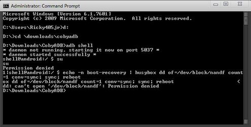

"device doesn't reboot at execution of cw " I mean when CWM is installed via "root_restore.bat" it shows that device will reboot into recovery but it doesn't do anything!.
" if I reboot with b it reboots rom only" I mean when in "root_restore.bat" I do b for rebooting it reboots oke but not going in recovery.
$adb2.JPG oke here and if I'm doing something wrong let me know cos all this happened after doing a restore of system.tgz in your link to restore

I don't know what you are doing, I don't know what root_restore.bat is, seeing you aren't using the root method I posted I wont be able to help you. Your pic shows as I stated you don't have data mounted, that is your main problem. also if you restored your system.tgz you wouldn't have cm9 on your tablet, your posts are just too inconstant for me to follow.
I posted instructions for you to restore your boot,img, bootloader.img and system.tgz had you done that you would be stock, not be running CM9, at this point you really have messed your tablet up by not following any instructions that I posted, you are using some other root method than what I posted, the problem with using bat files is the user in this case you has know ideal what the bat file does or even if it is working. Had I known you were using bat files I wouldn't have even tried to help you, to restore or fix a tablet requires adb command line, I need to see the response of the command and the command you typed. You now have no data or cache so clearly the tablet is confused and doesn't know what you want it to do.

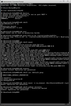

$adb3.JPG ok I'm looking now forward to make SU grand shell permissions cos in SU log I get everytime Shell denied and no prompt to allow?

View attachment 10859 ok I'm looking now forward to make SU grand shell permissions cos in SU log I get everytime Shell denied and no prompt to allow?
You can't you can't write to it, a ro will never grant su privilege, you will always get permission denied, you must mount data partition then only through data partition can you write and get su permission.

No such file or directory means the /system partition no longer exists and cannot be written to. Therefore, unless you want to try searching for LiveSuite to try and recover things that way, this tablet is a brick and you'll need to exchange it for a new unit if possible.
Agreed nothing else we can do.
