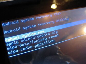

With a customized U0 which is also known as u-boot-nand.bin we could possibly get a recovery menu as pictured below on a SuperPad. This would allow us to apply custom updates using a very simple update.zip located on a microSD card. Devices like the nookcolor and many phones have this capability allowing for the non-technical user to update their device without a lot of hassle.
