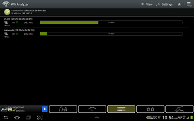

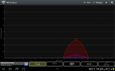

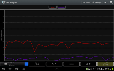

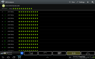

anything else pops into your mind? $Screenshot_2012-10-18-10-53-55.png$Screenshot_2012-10-18-10-54-11.png$Screenshot_2012-10-18-10-54-21.png$Screenshot_2012-10-18-10-54-27.png
Hope these would help you figure out an issue.

That's pretty poor. It certainly isn't a channel conflict but the signal is terrible. You didn't say how far you were from your router but what I see there would be typical of something far far away. I'm thinking you need to find a public WiFi hotspot or a friend's WiFi to eliminate your tablet as the problem but my guess is that you might need a new(er) router, or newer firmware in the router.
Those charts are so poor I won't even ask how fast your Internet is supposed to be, yet. ;)

I was right beside the router when those readings were taken. Internet speed is in fact slow, but not as slow as it is now.
