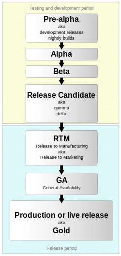

fuser said:
I don't see any compatibility zips for any of the 3 batches of Crystal's here.
This is marked as an alpha, not a beta, not release candidate, not a public test, not a pre-release and certainly not a stable.
Patches will come as they are made public.
Alpha
The alpha phase of the release life cycle is the first phase to begin software testing (alpha is the first letter of the Greek alphabet, used as the number 1
Alpha software can be unstable and could cause crashes or data loss. The exception to this is when the alpha is available publicly (such as a pre-order bonus), in which developers normally push for stability so that their testers can test properly. External availability of alpha software is uncommon in proprietary software. However, open source software, in particular, often have publicly available alpha versions, often distributed as the raw source code of the software. The alpha phase usually ends with a feature freeze, indicating that no more features will be added to the software. At this time, the software is said to be feature complete.
When this is a postive, or packed with compatiblity zips then people should flash, until then alpha should only be used by those with the intent of debugging software, there are over 210 online crystals that checked for updates via UpdateMe in the past 24hours so it certainly is working well for some, or those with the sense to read the props, or run the boot in a debugger as there are no notes to go on, only a fool would flash blindly.
You also have to consider release numbering is in the negative, 003 incomplete, 100 would be 1.00, please do not come to this forum, smash up things and except respect, respect dear sir is earned not given
