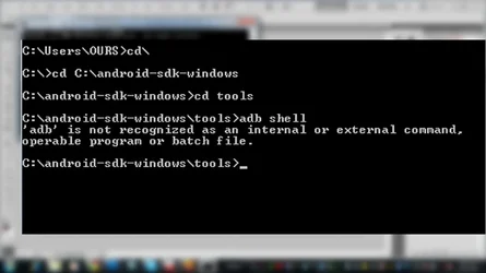

damn i forgot how to adb shell into the freakin thing...check the pic, this is how i'm tryin to do it

Remember, if adb is not on your system path, you have to be in the right folder to use it. I think yours is in platform-tools (not tools). ;)

ok this is what i did..i found the apk for root explorer, then i adb installed it. rebooted the nook and boom, i got root explorer installed, with which i can now mount the system/app directory as r/o or r/w!!!
