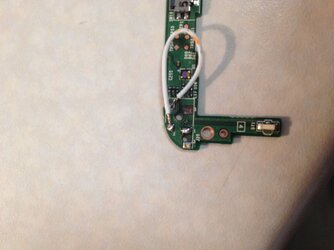

Someone just brought me a Vtab with the exact same problem.(dropped, headphone jack ripped out, no sound)
If you can live without the headphone jack, there is an easy fix.
The two damaged solder connections furthest from the hole can be bridged. I soldered a small peice of wire across these two points and regained sound on the device.
If you dicide to do this: Bend the wire into a U shape. Tin the wire ends. Press the wire ends to the solder points. Then, apply heat.
This worked great for me.
P.S. You can bridge the points with a paperclip to verify you have the right two. You have to do this with all three cables plugged in. When you are on them you will hear sound. Do not try to use the paper clip permanently. Use a small copper electrical wire.
GOOD LUCK !!!
For anyone else looking into fixing their headphone jack port, and you can live without the headphones. I found the statement "furthest from the hole" confusing. The holes are numbered and it is hole 2 & 4 that need to be bridged. I have attached a photo to clarify. $vtab.JPG
