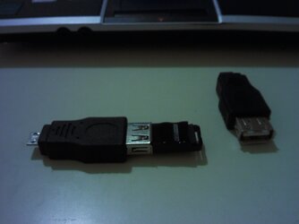

Wow that's a messy cable hack!
I ordered two of these and they work fine.
I'm using them with Dane Elec micro USB adapters and 8Gb micro SD cards.
sopare2000
May 5, 2011
11
Information taken from Russian forum
Do not work, you need an OTG cable, micro usb is 5 pin and 4 pin usb, contacts 4 and 5 cross.
Russian but it is understood
or made ebay
Micro USB male adapter OTG for Mobile Phone Pad Tablet en venta en eBay.es (finaliza el 05-jun-11 09:27:54 H.Esp)
Micro male to USB female cable adaptor converter plug a en venta en eBay.es (finaliza el 09-may-11 21:58:19 H.Esp)
Hey buddy i ordered the second item u posted from ebay do u think it will do the job or i should have ordered yhe first one which says usb otg
