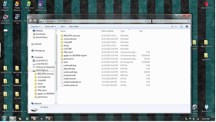

----> is this how it should be copied..? and how will i run the ADB commands?

i got the commands running.. :) but i don't have system.tgz in my dump..is there any other place where i can get it?
