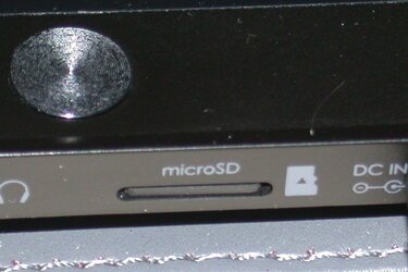

Here's a photo (if it lets me) of it installed correctly at last in my 7015.
Hmmm... could be a hardware problem. Have tried to do a system reset from recovery? I have three of these units and they read the cards fine.
