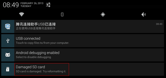

$QQ截图20130226085110.png$QQ截图20130226085230.pngthis is my external sd card

im facing the same prob (SD damage) before.... you can try to roolback the version to stock rom 2.2 (official Hwawei rom)...it will reformat the partition on your internal SD card due the costom version is not partition your SD card and only format it. ;)
Dear syidisma,
I flash my tablet to 2.2.2(official rom) , the internal SD still available ,I think it's sure damaged!:(
when I upgraded to the newest cm10 build 20130226. the sd card is relive, thanks again

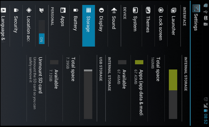

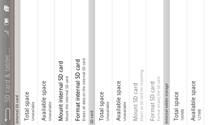

Yes,my sdext damaged. I try to format it on device and cwm,it still damaged
that requires changes in the kernel ramdisk (need to unpack the boot.img and edit the ramdisk/init.s7.rc and repack it)
anyway if u leave the internal sd unpartitioned, u can switch the internal-external sd in my latest build (settings / advanced settings), i havent tested coz i dont have external sd, but it wont solve the that the /data (where are the apps) wont be bigger than 160mb

I use syidisma's method ,and upgrade to the latest build ,the internal sd is alive again , but when I mount to windows and chkdsk , it's corrupted , so it's unstable , and I tested the (advanced settings / Swap internal-external sd) it's ok
thanks your hard work:)
I tested the (Advanced / tablet UI ) ,and change screen density value to 120 , very comfortably.
