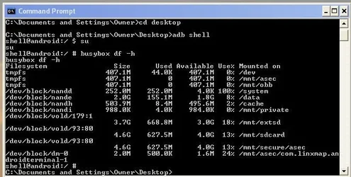

It's for sure the space issue, I have tried to go into the android terminal and remove some of the apps, but they say it's a read only system..

You need to enable root for ES File Manager. Then you go into /system/app using ES File Manager and physically remove the app, either by moving or deleting it, to uninstall it.
