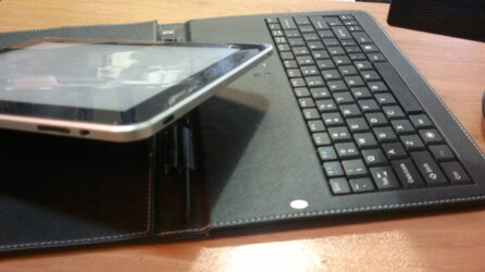

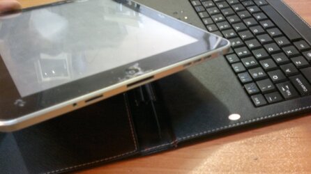

callh
Jan 1, 2012
hi, happy new yaer..
i have chaina table and don't know model..
i want firmware and model #..
