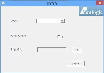

Win 8 64 bit, then you need to change the properties of sdcardmaker.exe (right click, Properties, compatibility tab) to Run as administrator and also run in compatibility mode for WinXP SP3, before you execute it....
The top field is for you to select which drive your sdcard is... (Make sure you select the right one to format)...
You add a check in the box of the second line.... (Creates a boot sector on the sdcard to place the bin file to)....
And the third is for you to select the bin file, (where ever you put the ZT282.sd file you renamed to ZT282.sd.bin).....
When you press the bottom button, it should open the normal Windows format window, then just normally execute it to format the sdcard....
After the format is over, then copy the zt-update folder of the 0818 ROM to the sdcard and insert it into your tablet and press the power button...
