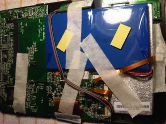

Hi,
I have a 7" INCH MID Tablet ANDROID 2.2 VIA 8650 EPAD, green LED / no vibrate which I bought from ebay and which I had left with the orginal setup.
This week when I was using the tablet with battery fully charged when suddenly it froze and switched off. when I pressed the power button this remained off and no combination of buttons seemed to work.
I decided to take it apart and check if something was loose. After reseating all connectors and pressing the chip in the removable clip on module, I managed to make it boot. While I was at it I also changed the speakers position upwards which significantly improved the loudness. I was happy since even the touch screen was still operational.
This was shortlived however when I tried to switch on the wifi. This starts scanning and then gives 'unable to scannetworks' and switches of. 3G dongle worked fine.

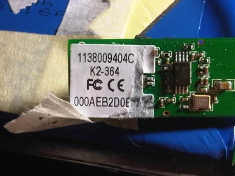

i) Wifi card (k2-364 photo attached) is faulty. appreciate any recommendations from where I can find the replacement or equivalent
