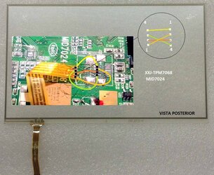

hi, adapted touch upload image.
Mod: COBY KYROS (MID7024)
Touch: XXJ-TPM7068 (generic) Aliexpress 7" 4 wire $15
