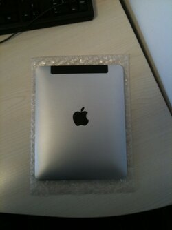

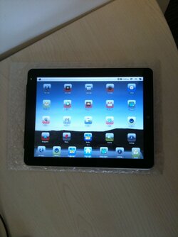

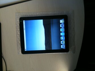

ill post some pics later of mine
its all aluminum/glass , running 2.2 and has the look of a certain famous tablet:cool:
