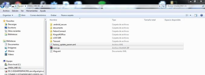

So i download that file and unzipped then i copy both files, root.zip and Factory update.aml to my root directory $Captura1.JPG

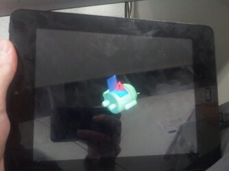

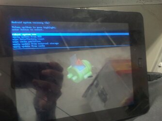

Then i enter on recovery mode and nothings happen, just appear my android death!!$IMG_20121126_210909.jpg$IMG_20121126_210923.jpg
It can be the factory_upload_param bad update_package path??? i saw when i open an file manager app that my sdcard is under mnt/sdcard i must chage that?
