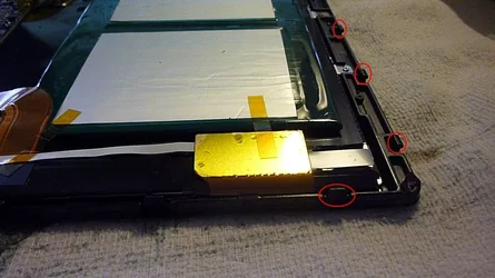

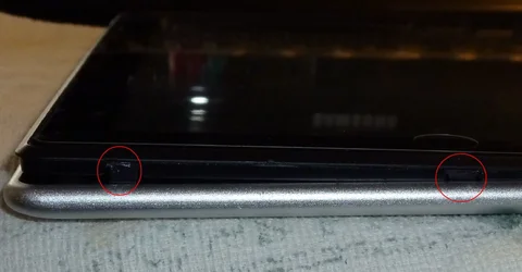

Starting at the opposite end to the On/Off volume buttons you will be able to "feel" a small indent between the alloy case and plastic surround.
once one of these is found, apply a small amount of pressure inwards and GENTLY lever the case and screen SLIGHTLY apart.

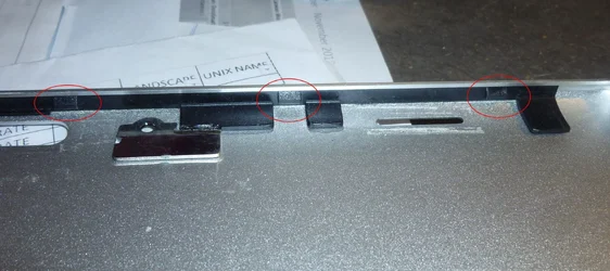

NOTE: putting something between the case and surround will prevent them "CLICKING" back into place.
these clips are approx. 50mm apart

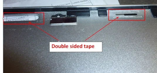

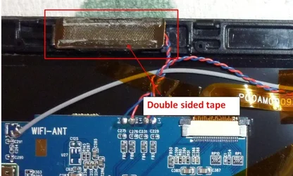

work your way Alternately around the sides until the case starts to come free. USE CAUTION near the speakers and wifi antenna as there is double sided tape holding these items onto the case.
