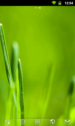

w00t, after playing around with SystemUI i managed to hide the signal bars and alarm clock icons from statusbar :D
i have alarms set, and no annoying icon :p

Getting rid of cell standby (battery drainer) is pretty easy, and removing the icons is just as easy, although a bit more involved.
To disable cell standby, thus increasing battery life:
  • Get a file explorer with root capabilities (i used file expert, free and no ads ^^)
  • navigate to /system/app
  • rename Phone.apk to Phone.apk.old (disables it, and lets you keep a backup just in case)
  • rename TelephonyProvider.apk to TelephonyProvider.apk.old (same as before)
  • reboot your tablet
  • to ensure cell standby isnt eating your battery life, let your tablet charge fully, then check battery usage and see if its listed (to view battery usage add a shortcut to the homescreen, settings>battery usage (its hidden in the actual settings for some reason))
To remove useless icons (Home, Volume up/down, Menu, Back, Cell signal, Alarm):
  • download View attachment 5496 and extract the apk from the zip
  • from the market download ZipSigner 2
  • put the SystemUI mod on your device somehow (using a PC and USB will work, downloading directly from tablet works)
  • using ZipSigner 2, sign the file with the key "platform" (press "Choose in/out" button, select .apk file, choose platform from pulldown under Key/Mode, press sign the file)
  • navigate to /system/app and copy SystemUI.apk to SystemUI.apk.old (this is for a backup, just in case CAUTION: renaming or deleting the file will cause an infinite loop in the device telling you "Sorry, systemui has crashed, try again")
  • copy the signed file (the one you made with ZipSigner 2) to /system/app overwriting the original (make sure you have a backup) (after overwriting, the statusbar will disappear and won't return until reboot)
  • reboot, when your tablet is done rebooting the icons should no longer clutter the statusbar
A word of caution, unless your absolutely positively sure you know what you're doing, NEVER delete a system file unless you have a backup (even then, be cautious about messing with system files)
I hope this was clear enough :)
