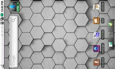

#2) Lock Screen icons oriented wrong on first boot
