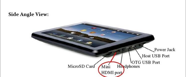

I did notice something strange though, i kept on seeing the USB method of burning the firmware to the device, instead of using a SD, which included attaching it to a computer via OGT (correct me if im wrong) port, and not the Host port. The only problem with this is that my tablet has two HOST ports, and no OGT ports, i searched everything i could and couldnt find any other device like that (maybe if someone has one like that, they could provide a model #?) so that kind of dismissed the USB method since i tried multiple times to connect the tab to my laptop with no luck whatsoever, wouldnt even recognize it exists.

Sears has been selling the SYNET7LP for the last year of which seem to be Hardware Id "hwver" 11.2.1.8 with two USB ports, however this firmware has caused the most issues with bricking tablets. One option would be to try the beta4 version of this Hardware Id "hwver". The OTG port is the one closest to the mini HDMI port. To connect via PC (Win 32 only drivers) also needs a key pressing to interrupt normal boot sequence. The SD card method using this version has been confirmed to work. But the best option would be to Expert burn on the backup system image SYSBACK - zSYS.img from the InfoTMIC Update Wrap thus eliminating the possibility of burning the incorrect U0 "u-boot-nand.bin" image.
