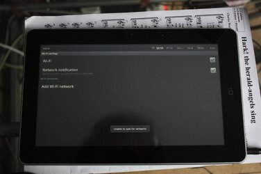

Ok I have the same problem. Wifi used to work fine. It started after I had my tablet hang at the Green WowPad screen. I was able to do a factory restore by pressing Power + Home + Back.
Now I cannot see any wireless networks when scanning:

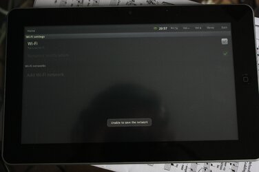

Nor can I add my network Manually:
At the moment, my seller is being pretty unhelpful. I've pushed the case to Alibaba's support asking for a refund. It happened after I'd had it a day!
