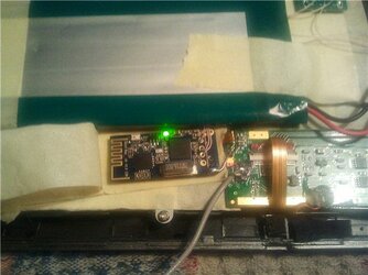

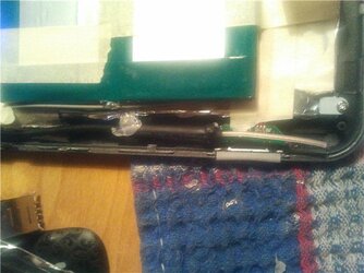

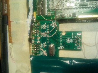

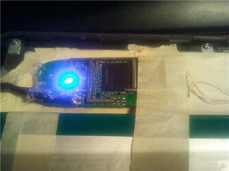

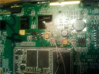

I moding my 1024 hardware - add 4 port usb hub inside + bluetooth + 3g modem (custom antena) + 1 port to external mini usb an lat one ithink use gps reciver.

You are really going to have to post pictures. I for one, cant wait to see that. good luck.

That is cool

Today test in city i anderstud that antena is not enough to god work.
Any body know beter solution - internal antena 1900 - 2100 Mhz ?

Korbank, that is proving to be very interesting! I hope you document the type of hardware ( make and manufacture) and the installation points on the board. I would love to add the bluetooth and 3g hardware internally to the tablet. Good Job.

Very interesting. Please start a new thread with more info about the parts and instructions. I am sure many users (not only MID1024 users) will like it. ;)
