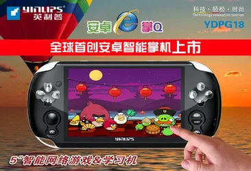

Hello KK,
I you have time, please check out this device... it falls in the spectrum you would consider.
Its an YINLIPS YDPG18
As well as being a 5" tablet... it's also a retro gaming device with d-pad, shoulder buttons, analog stick (although no one knows how to enable it) .
there are two versions of this device... and the newer ones have the A10 boxchip.
There is a web site with a few members who would love this type of mod for this device.
Please check the website dingoo-scene
Feel free to send information there or here.
I will attempt to gather the information and file you need, but my skills with adb are limited, and am having trouble with my OS as well. (Vista 64bit)
The device seems to have root access from the company, but the superuser is not there, or working right.
Thank You
picture of the device YINLIPS YDPG18
Note: this device uses a resistive touch screen and not a capacitive screen, although you can use your finger, it feels much more responsive with a large stylus. (well, it works much better anyway)
yinlips info
