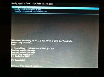

So I did what you instructed and am at the screen below. Do I just go back to the main cw screen and reboot now or do I have to do something more? I have gotten to this point before and just rebooted, resulting in the issue of not booting to cm10 and just sitting on a black screen.
reboot and see what happens, wait a fews minutes then if screen still black

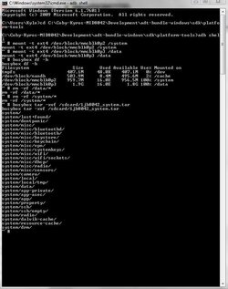

In the partition tool the partitions show up empty, but then they show up full in adb. Do I need to wipe cache partition or dalvik cache before doing this? Just trying to eliminate anything that might be causing issues.
Won't hurt
do busybox df -h before and after push so we can hopefully see whats going on.
I wiped both and tried again, doing busybox df -h before and after and nothing changed. They still show 100%.
