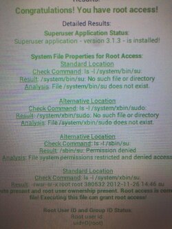

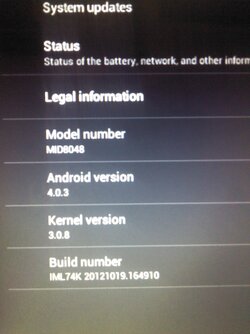

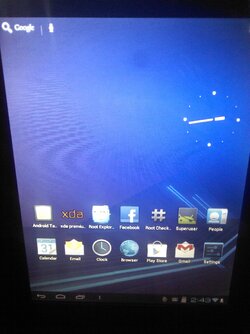

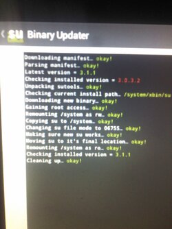

i would like to take the time to thank everyone expecially vampire and traveller for helping me to get this far with my 8048-4. without you guys it definitly wouldnt have made it. i thought i would upload some screenies of the device after root and gapps install. also threw in some superuser screens, the su binary updater which sucessfully updated to the newest version this morning. the root check results are there to..just trying to provide as much info as i can on my side. the screenies were taken with my phone since i havent found a screen capture app that wouldnt let me take anything besides the homescreens. the previous i used were built into my roms on my phone. the device did get a little bit slower after the root and gapps process. i installed apex pro and dropped a couple of homescreen and set the background process limit to 1 and it helped a little bit but i would like to overclock it to about 1.2-1.4 i think that would help if you know any apps are compatible couldnt find any on GP. anyways im hoping with my system dump,and the info in these couple threads we could possibly have a cwm recovery for this device. Thanks again guys and any further advice is very much appriciated.
