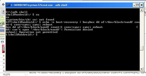

If tablet is rooted and usb debugging is turned on you can use adb to factory reset and force tablet into recovery. I can't explain how to set up adb to windows users, I don't use windows. I work on tablets all the time, the owner did something to this tablet to cause this bootloop most likely tablet will need to be returned to Coby.

You need to open terminal window
type
adb devices
you should see something like below
Code:
List of devices attached
464119de1212148	device
if you have a listed device similar to above then do below commands.
adb shell
su
echo -n boot-recovery | busybox dd of=/dev/block/nandf count=1 conv=sync; sync; reboot
will boot you into recovery
only if you have adb setup, usb debugging on, and tablet is rooted.

Ok, I think it's not rooted or maybe I'm typing wrong.
Wooooooooooowwwwwwwwwww it's working! Thanks so much vampirefo and all the users!
I rooted the tablet with this instrucción http://www.androidtablets.net/forum...ead-first-development-index-root-utility.html
Then I opened a terminal windows and wrote:
adb shell
su
After that Android logo appeared and a pressed "back" (Bottom). So recovery mode was running. Then I just did the recovery factory and done! My tablet is working!
