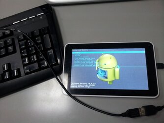

For those having scrolling issues after installing cwm recovery here's a tip:
Plug an external USB Multimedia Keyboard onto your D2 and then you can scroll by using the Volume Up, Volume Down and the End keys.
