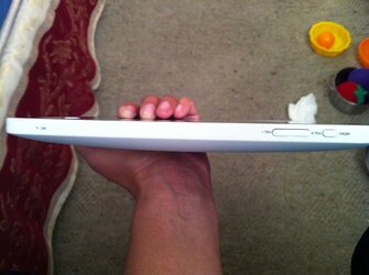

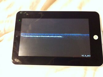

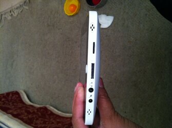

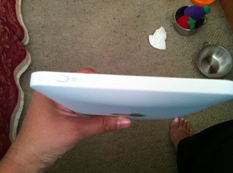

HELP!! First off I dont know if im in the right spot so please bear with me and please help! I purchased one of these ipad knockoff so I dont know what version or what the heck it is? Ipad,Iped,Apad??? I turned it on and It was working fine later on in the evening I turned it on again and the android little guy was stuck on the screen and did'nt do anything so I read your forums and put a running system on it and then the screen became fuzzy like a bar in the middle of the screen, then I tried to turn it on the green light goes on but doesnt turn on and then when the charger is plugged into it the red light goes on I guess it's charging?? I just want to get the thing back on and running again the manual doesnt really help I dont have a reset button or hole?? The screen doesn't turn on at all!! I don't know what to do I was possibly thinking that mabe I need a new root download?? Vicky
Vicky,
Depending on what model you have there may be a small button on the back of the tablet. If the tablet is securly mounted to a book-styled cover it is probably a x5a or x6 which will have a reset button (hole) to the right of the memory card slot. If not there is usually printing on the back side of the tablet that will point out which hole is the reset or there will be one on the backside...all tablets have a reset button.
Cheers
Thanks for responding I've been looking for a reset hole but there is nothing the only hole is the mic hole and i tried that but I dont think thats a reset nothing happened? The backside believe it or not says apple! 64gb thats it??
Hi Vicky
your Pad sounds like nothing i know from the top of my head.
usualy they do not have this 'apple' print on them.
Please make some pictures of the pad (front and back) and the plugs (power, usb, headphones...).
Maybe a link to where you did buy it from or what specs it is supposed to have.
Sorry it sounds like nothing youve heard of I'll upload some pics! Thanks$IMG_1476.jpg
