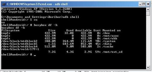

For the OP, enter USB Debugging mode on the tablet, run the following commands, and post the output?
Code:
adb shell
su
busybox df -h
The output will tell me what I need to know.

hey this is my output of my device?
