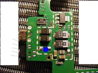

I have the same problem. Is due to the power jack on the tablet. If you look inside it, the metal in the middle is broken. I searched a jack identical but have not found. The only way is to remove the two wires from the (+) and (-) and connect a different type of plug. The problem is I do not know which are the polarities on the motherboard. $contacts.JPG
Check the polarity symbol on the case. It will look like either of these:
The third contact of the five that have lines running through them in the image you provided is the center pin, which is the dot with the line leading to the + or - mark on the right. The barrel connectors will be the opposite polarity.
If you could measure the polarity, then why were you having an issue with the polarity not being marked on the motherboard? Or did I misunderdtand you this morning?
That bottom negative could be the ground. The two positives and two negatives are plausible, but powering it up is the only way to be sure.
Thank you Traveller. Socket on the motherboard is faulty. When inserted power jack, I can not see what polarity is on the motherboard.
The piece of metal in the middle socket on the motherboard is broke and remained in power jack. Because of this no longer feeds the tablet. In my opinion this is the problem for all colleagues from this post. I apologize for my english.
Then there's nothing to do but wire up a new jack using those contact points. Desoldering the old jack from the board though might clarify whether that bottom pin is negative or is, as I believe it to be, ground.
