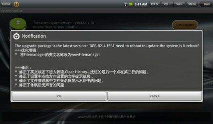

I have been recieved a Rochy 10A
Model number: deb
Firmware version: 2.1-update 1
Kernal version2.6.32.9 hzhao@emma #1
Build number: deb-r2.1.1170
This equipment has been certified by wowPad
I though it was good when I first turned it on yesterday hooked it up to my wifi, and found an update
When I process through the following appears
it is in chinese (I assume), so simply agree.
It took about 1 hour to download, then it shut down, and sat on the infoTMIC screen for 3 hours, I then forcibly shut it down.
