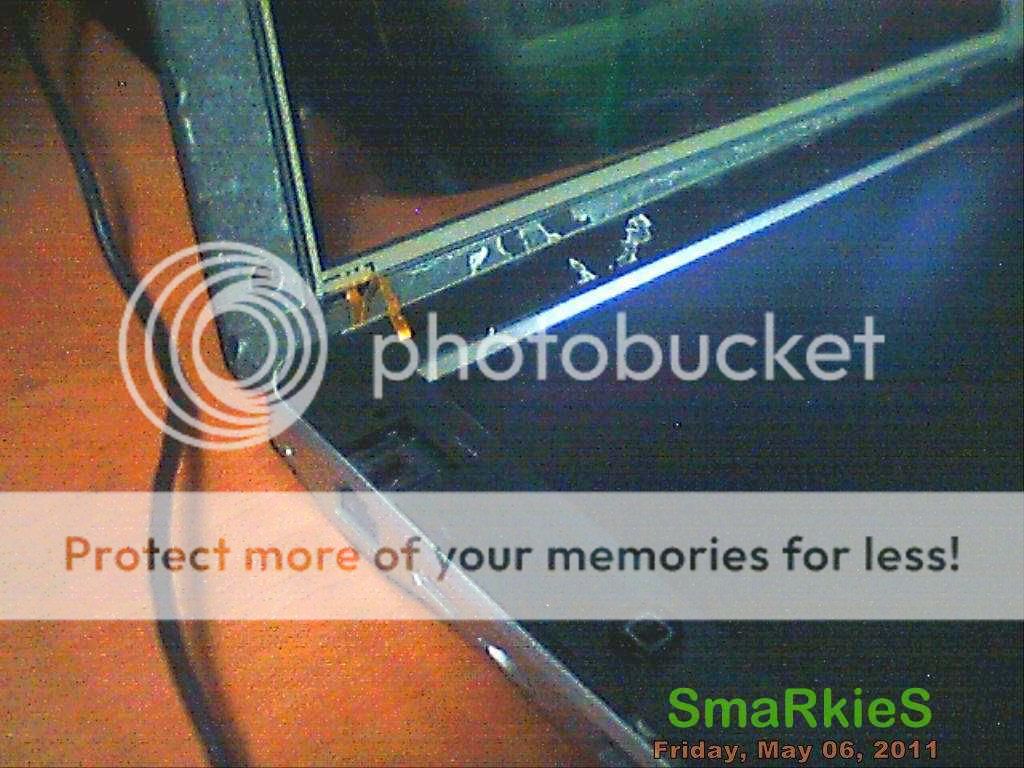

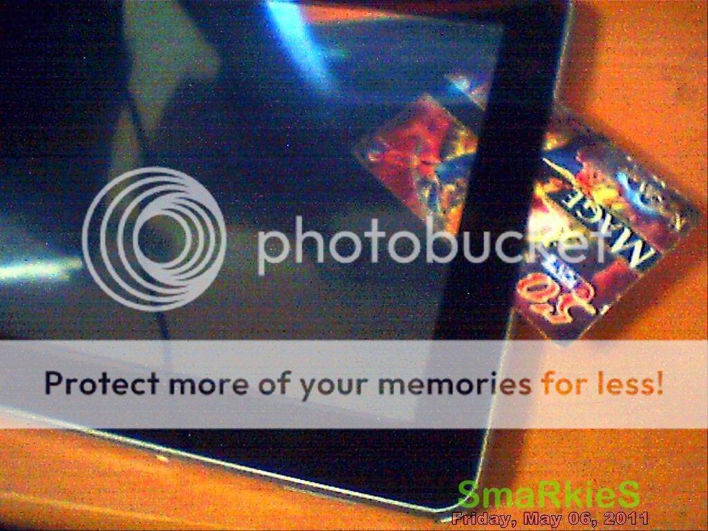

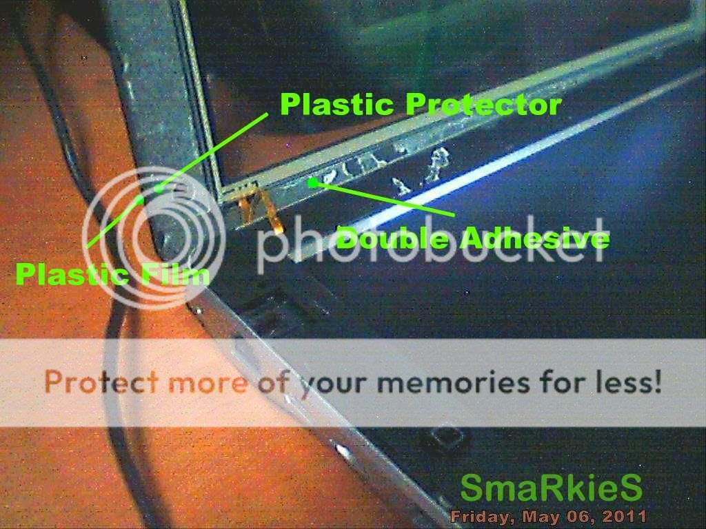

I start using the thin plastic card on the side, slide the card on the 2nd layer of the plastic, just be careful with the plastic layer, make sure it's not the thin plastic film you peal off (see picture)
The screen is using double sided tape adhesive (see picture)
Slide the card, just follow the red line on the picture, stop on blue line where the flex cable is, or else you will cut off the flex.
The start prying next plastic layer, just pry it towards you it will unlock the plastic tabs, if you don't have any prying tools, just use any plastic tools, don't use metal tools because it will damage the casing.

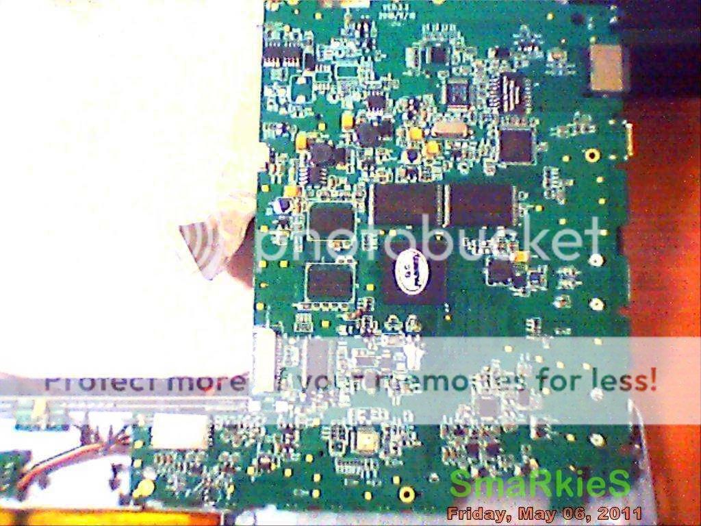

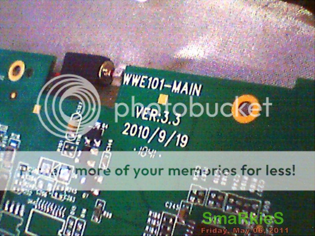

Main board Version.
The battery, 3800mAh x2.
Wifi module and antena

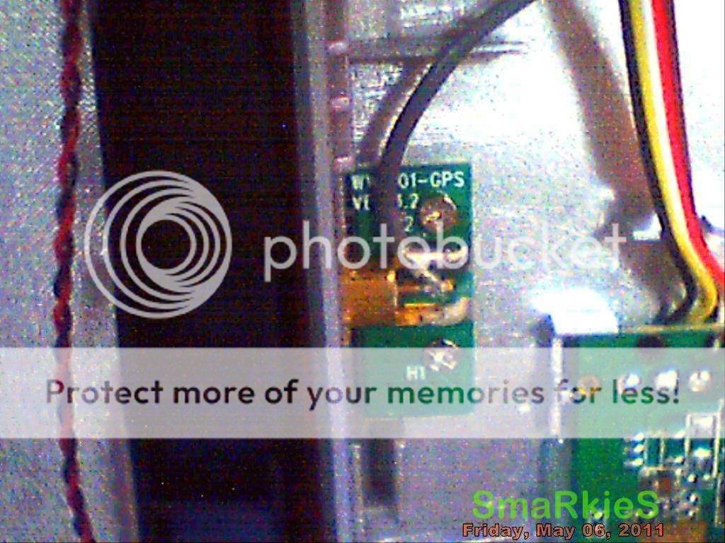

GPS Port, and GPS Module on main board.
Realtek Lan
Samsung ROM i think.
Hynix RAMS 256MB, no way to upgrade it.
Processor/Chipset/GPU infotMIC IMAPx210
HDMI Chipset.
