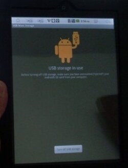

You enable USB on the tab by dropping down the top notification bar - tap and drag it down - it's hard sometimes w/ all the jitter.. I kind of tap and 'flick' w/ my fingernail a bit.. Anyhow - amongst other things listed there - should now be a notice about USB - click it - it'll bring up a new menu that someone in this thread posted a nice pictre of - press the enable button and .. hopefully - you'll see 3 new drives appear in Windows explorer (they'll be different on everyone's computer depending on how many drives you had to start w/ - so I can't say Drives are J,K,L)
