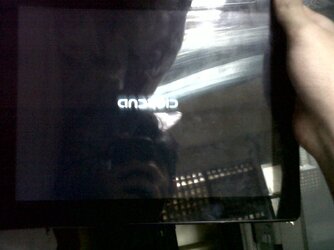

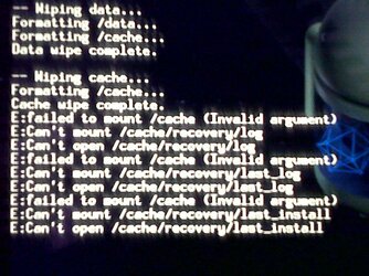

Hi my father gave his tablet because it was stuck in android screen boot logo.. and i didnt know what he did to it.. i put it on recovery mode( volume + , back, power button) and i tried to wipedata/factory reset and wipe cache partition it was successfully, and then i reboot it but its still stuck on android screen boot logo... the tablet was not rooted... what should i do??? i am only able to access into recovery mode, not in my android tablet
thanks in advance
take a look the image below for clearly.......
hope someone could solve my problem... sorry for my english if its bad im filipino
Looks like you have a big problem. Invalid argument would mean, if I'm right , wrong scripts. And you also have mount problems.
Can you post a pic of the recovery?

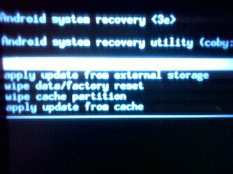

@Ricky405jr - here is the android recovery mode
Reboot system now
apply update from external storage
wipe data/factory reset
apply update from cache

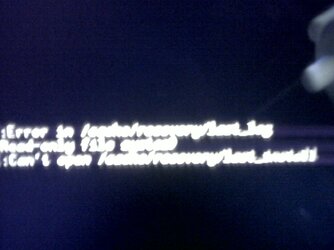

when im in recovery mode i seen this error
E:Error in /cache/recovery/last_log
(read-only files system)
E: Can't open /cache/recovery/last_install

From all appearances, you're screwed. You have only the stock recovery to work with because you're not rooted, and with USB Debugging likely off when the tablet committed seppuku there's no way whatsoever to correct this using the tools available on the forum. You may be able to fix it using LiveSuite and a LiveSuite ROM, but you'll have to search for both of those items on the Internet as links to LiveSuite and its ROMs are not permitted in the Generation 3 section.
