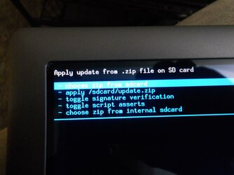

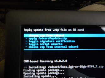

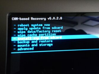

Use the volume buttons on the NT and
Tab down to install zip from SD card and hit the “hard“ (n) button on the bottom center (actually right center when holding horizontal) of the NT to select.

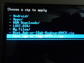

Select choose zip from sd card and and and hit the “hard“ (n) button on the bottom center (actually right center when holding horizontal) .

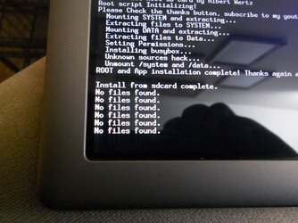

when I select choose zip from sd card and hit the hard n it says "no files found"
Any help would be mucho appreciated.

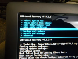

if this helps anyone I am already rooted.
but when it comes time to load up all the jb stuff and gapps it says file not found,
I have used 2 different cards to rule out if it is a bad card situation.
I guess where I am at now is loading up the JB?

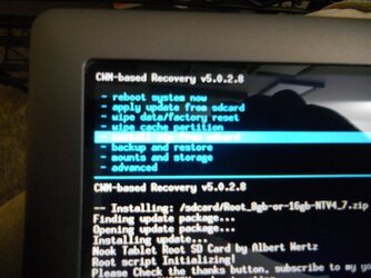

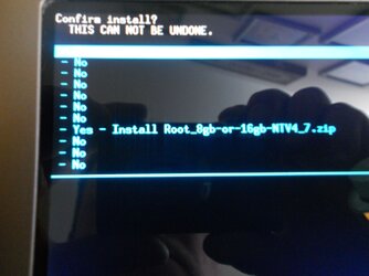

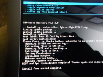

Okay here is what I have done.
I am only allowed 5 pics per post I'll brb
Whew! wish I knew how to thumbnail those gigantic pics *ashamed...lol
File not found! what to do what to do......*sighs

STEP: 14
Now no matter what rom you will end up with first choose cm-7-TEAM-B-BETA1-signed zip, and hit the “hard“ (n) button on the bottom center (actually right center when holding horizontal)
[FONT=Arial, Helvetica, sans-serif]cm-7-TEAM-B-BETA1-signed zip is the file I next need to install but it says file not found...any thoughts from the tablet community?[/FONT]

Update:
I found the problem....wait for it...
faulty connection from nook data cable/charger
when the connection is faulty ClockWorkMod wont read the external SD card,
I'm guessing something to do with like when you flash it has to have
a continuous power supply as not to be interrupted in the middle of flashing by critically low power lvls.
So I was able to load the files.....YAY ME!
