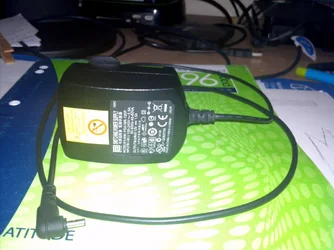

my charger is orginal and i tested it by multimeter there is 12V dc
i buy an external 9V & 5A charger to charg my battery without my tab

Your charger should look like this with a very short cable.
