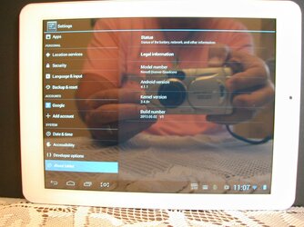

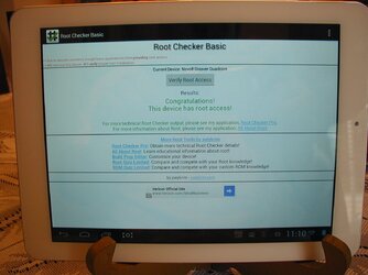

Just thought I would post this about my new Ainol Novo 8 Discover. Received it last week and discovered it arrived already rooted! e-Mailed Ainol and I am still waiting for their response as to how this happened and how to correct. I downloaded a root checker from the Play Store and it confirms that the tablet has root. Tried SuperSu to do temp un-root but no luck. $Ainol 01.JPG$Ainol 04.JPG

O.K. sorry, I thought it was clear I had no success with OTA Rootkeeper as suggested by Frederuco. Also tried Super SU with no success. As for your suggestion it may well be the way to do it but it is way above my current abilities. Hopefully I will learn from these forums and gain the skill level that I need. Thanks!

O.K. Did all that but root checker now says "sorry this device does not have proper root access. Flixter still warns that the device is rooted and won't stream movies.

The tablet isn't rooted any more, I don't know what the other app is checking for.
