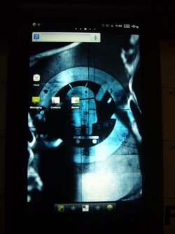

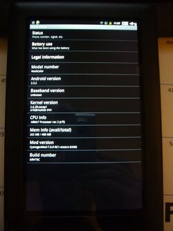

Well check this out! I got me some CM7 loving going on!

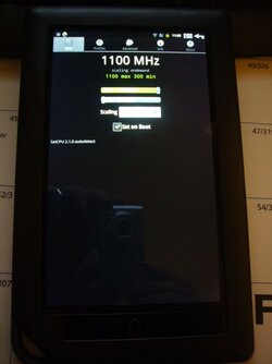

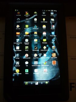

I went through the process and it was actually pretty painless. Everything worked first try for me, but I know that was probably just luck. I used a new SD card and was able to overclock right off the bat as well. Market works fine, and so far so go. I am going to install my apps from Titanium next and play around. We just might have the daily driver folks! (I wonder about the B&N books i bought though?)
Here's my diary of install:
I've attempted to improve these instructions, and have placed them in the proper thread here: Installing-Updating-Removing CM7
I will prepare a more detailed instruction set for just creating the ext4 SD if people want me to, otherwise, just follow the links in the OP and happy trails. :)
ps - does the paid version of titanium solve my issue of having to tap "install" and "done" for each individual app on a reinstall batch process?
