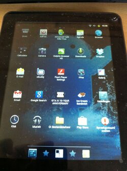

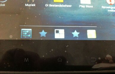

Hi, I made a rom named Blue Water (still open for other names) for the following devices:
MPMAN 827 - Mediox MID8027 (tested and working on MPMAN 827).
DO NOT INSTALL THIS ON A Kyros MID 8027
Looking like this:
Screenshots:
Blue water contains the following:
-add root by default
-LCD Density Change to 160
-add setprop au.ui.enable_auto_sd_path_env true to init.smdkv210.rc ( allows apps to automatically detect external SD card rather then the internal)
-added ro.media.enc.jpeg.quality=100 to build prop for better jpeg quality
-added debug.sf.hw=1 to build.prop for Hardware accelerated/Rendered UI
-added windowsmgr.max_events_per_sec=150 to build prop for improved scroll response
-added debug.performance.tuning=1
video.accelerate.hw=1 to build.prop for better touch response.
-Removed standard junk APKs

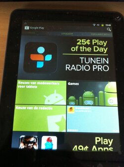

-add latest play store
-add google apps
-change default background
-battery saving tweaks
-web browsing speed improved
-increased VM heapsize
