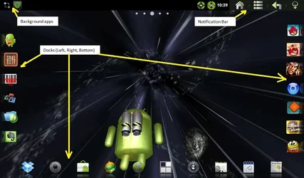

newbie question:
How to add the "background apps" icon of the 3rd post?
