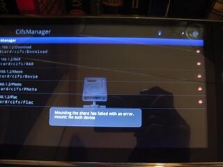

but however ,one left , I cannot make CIFS mount work,
use CIFS manager to mount share always fail ,
look into module folder, no cifs.ko , ???
could you tell me how do you make CIFS mount work ?
appreciate....
there is no cifs.ko module, i compile cifs built in to kernel.
take a look my thread (see my signature below) how to use cifs.

I've seen your instruction before I try already, and get fail,
I used to be successful on my another HTC HD2 with MOD ROM,
anyway, I'll reinstall and try again the report ,
thanks again , both...

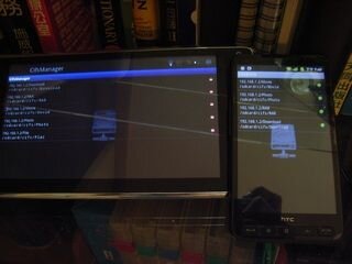

After reinstall and try , I still got fail, and my HD2 always successful, same APP version, same setting,
except my HD2 not built-in cifs.ko,
Very Strange...

i am not sure what's the problem because this kernel (cifs) working fine on my ROM. perhaps joe or somebody else using this rom can verify cifs mount. if it is not working then joe has something to do to his rom.
