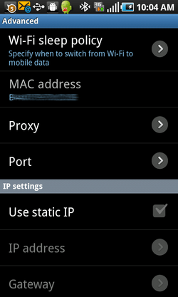

just an advise , can you install something to make the WIFI advance menu contains something like proxy setting
like this
