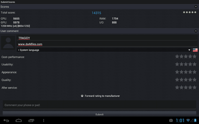

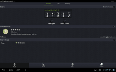

New antutu test for the allwinner A31 quad core using this custom rom
Score: 14315
