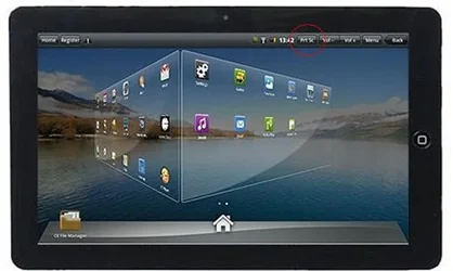

If you zoom this image, you can see that in whatever version of firmware on this infoTM device they have replaced the camera icon with "Prt Sc" so it is possible to modify.
Does anyone have the 3D animation depicted in the image after upgrading? I recall having this briefly when the device was new last Dec but haven't seen the ability to rotate the screen in 3D mode in a while.
Yeah that's funny about the Camera button.... it's' not a camera at all.. but it makes the camera noise ..lol... Calling it "Print Screen" is more accurate. Did they want to make you think it might be a camera?
Were did you get that picture, notice the extra hardware button on the right side panel.
Yes the 3D doesn't work with 2.2, it worked with 2.1, but I didn't find it very useful.
