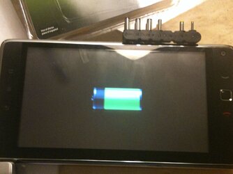

The powerline universal ac adapter works great set at 6v cost $20.00 at walmart
3rd smallest attachment $photo charging2.JPG$photo charging.JPG$photocharging 2.JPG
