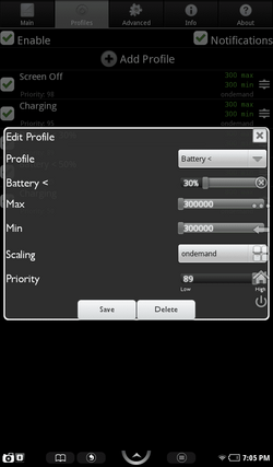

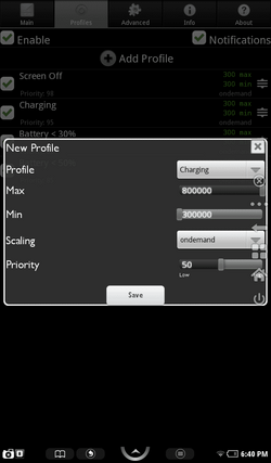

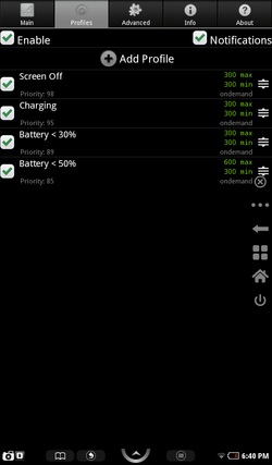

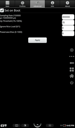

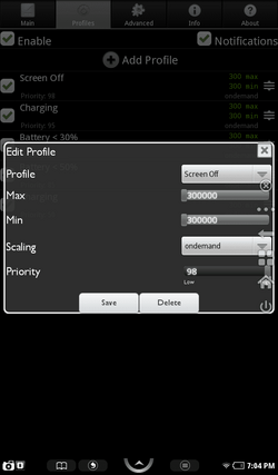

Set CPU...did I set it rigfht?

I did follow Rico's instructions but I didn't get such a major improvment in the life of my battery as other members claim, Here is how I set it:

Gloria,
The biggest power eater you did from you pictures was the up threshold at 35%. As JP said you should have it at 85-95%. Think of up threshold as percentage of cpu demand. At 35% you were telling the app to set the cpu at full 800mhz whenever the Nook sees a 35% or higher cpu load or demand. Since 35% is so low, having only 1 app open along with the android system itself, you most likely were always over that 35% so your cpu would be told to run at 800mhz most of the time. This would drain your battery faster than normal, even faster than if you were not running the setcpu app at all.
Also profile "priorities" tell the app which profile is more important than the others. The higher the priority number the higher the importance. Setting screen off is always most important since screen off or sleep is what your device will do the most.
