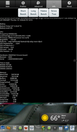

I. did check my- time in state- but do you think those numbers make any sense to me? Let me see if I can show you s pic of the set CPU into page.
JP, no I didn ' t do anything different in the first 50%or the second but I ' ll double check. I ' m getting I think over 7 hours of use just surfing and I ' m happy with it. I didn't read yet the instructions about overclocking but. I don't need it. I might do it just because it ' s easy. if it is easy.
$11-03-22-1.pnghere is a screenshot
That's a great pic, I can read it just fine. To get a really good idea of how long you are spending in each state you should reboot to reset the numbers and then record them just before the battery dies (or it is time to recharge).
So here are the numbers I was interested in...
Time in State
800000 787328 = 800MHz for 787,328 units of time
600000 4526976 = 600MHz for 4,526,976 units of time
300000 2364303 = 300MHz for 2,364,303 units of time
idon'tknow (haha) what the time units are but it isn't too important. From this we can do a little math and find that the percent of time you were in each state 800MHz for 10%, 600MHz for 59% and 300MHz for 31%. So we can see that most of your time was spent at 600MHz. I have noticed that the Nook tends to only drop to 300MHz for sleep. Even while idle it runs at 600MHz for a large part of the time when the screen is on (well at least if you have it auto checking for email, updating the weather, news feeds, running a live wall paper and so on).
