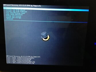

hello everyone. i just want to ask if there is someone can help me about my Coby Kyros 9740. it was stuck on CWM and i don't know what im going to do now. please help me, thanks in advance.

hello sir, thanks for your reply. here's what i did. i've downloaded 9740_secure_recovery_signed.zip then i "install zip from sdcard" then i select the file that you gave to me. then after i install, i turn off my device in 1 minute then i turn it on after i minute but i still back on cwm. did i do it right sir? sorry for bad english.
ah sir, is there any software like livesuit that can flash my device even in cwm mode so i can use the file that you gave to me?
in cwm select wipe cache partition
after wipe cache is done
mount and storage
mount /cache
then reboot system now

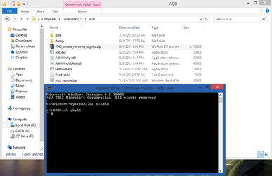

sorry my being noob sir. i only use cwm to flash the file that you gave. i don't get what you by to flash to new recovery and about adb setup. can you guide me sir on how to do it. your the only hope i have to fix my mid9740.
can i flash the file by using adb shell? if can, what command should i use?

You are doing it correct, just your cache isn't mounting so it's blocking the install.
Ok you have adb working so lets go that route.
download nand.ko
place nand.ko on sdcard
then mount sdcard in cwm
note using adb type one line at a time press enter after each line, so the command is give to the tablet.
open terminal
adb shell
busybox cp /sdcard/nand.ko /tmp/nand.ko
chmod 644 /tmp/nand.ko
insmod /tmp/nand.ko
lsmod
mount -t ext4 /dev/block/nandh /cache
rm -r /cache/*
now install 9740_secure_recovery_signed.zip
Below is what the commands look like in terminal.
