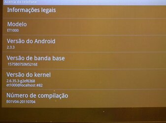

I have finish the upgrade 30 minutos ago also with Windows 7. Run mfgtoll in XP SP2 compatibility mode. Error after 3 minutes, but after desconect the device, it will boot with a nice android image and some guitar chords, and... 2.3 version! Doing some tests now.

Power ON. Congratulations, if you have done everything correctly, the device will boot with Android 2.3
